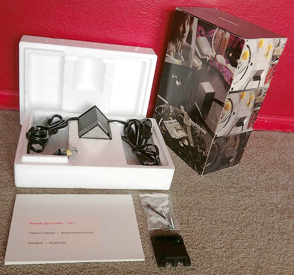

Light control LC 1.
 icontrol LC 1.ght control units
