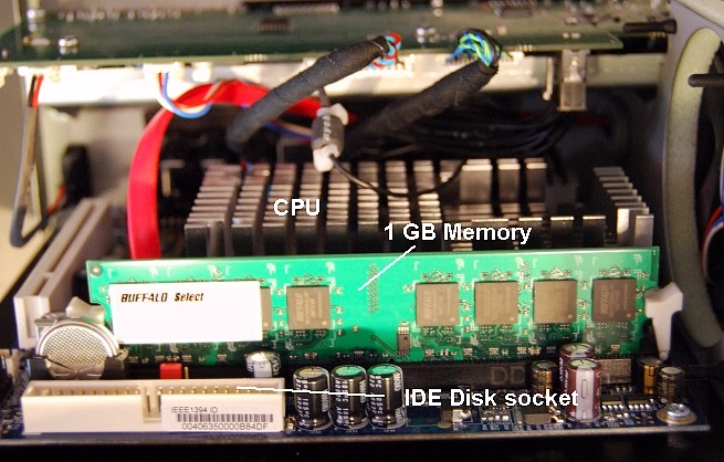

BeoSound 5/ BeoMaster5
VIA EPIA EX pro BeoMaster 5.
Link: http://www.bang-olufsen.com/beomaster5
Beomaster 5 Chassis.
BeoSound 5 er styreenheden til BeoMaster 5. Se YouTube video -
