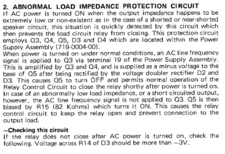

Accuphase_E_202_loud_pops_while_warming
Accuphase E-202 loud pops while warming up
My recently acquired Accuphase E-202 integrated has two problems (possibly connected?). The first part of the problem is a
hum before the relay kicks in. The second part is the random length of time it takes for the relay to kick in (5-25 seconds
maybe). The third part of the problem is once the relay kicks in there are a series of random speaker-blowing pops which go
away after a few minutes. ..
The hum, as long as it is pretty low-level, is normal. On power-up, the 202 feeds a weak 60Hz signal through the output relay
and the speaker wires and speakers. If a low impedance (under 1.5 ohms) is detected, the protection prevents the relay
from engaging. The hum you hear is, of course, the 60Hz test signal. Its audibility will depend on the efficiency of your
speakers. The rest of your ...
Det kredsløb der omtales trænger måske til en justering på din E-202 !
Læs mere under
Accuphase-E-202-Service-Manual
vh Hans Lund
