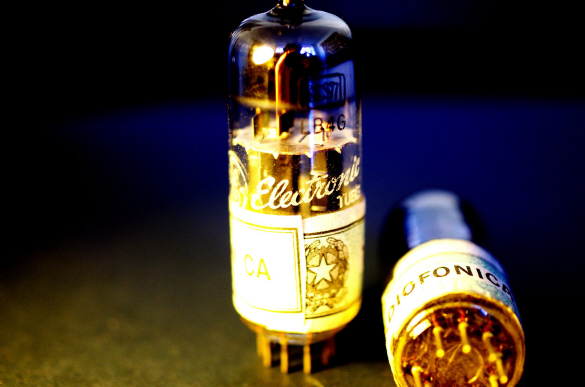

Jeg ved godt, det ikke er optimalt, men markedet er meget meget lille. Så lige, at The Tube Store i går skrev: “Note to Leben amplifier owners, we do not have matched sets at this time. These tubes are very difficult to find. Only odds and ends of various brands available.
Og et stemningsbillede af et fra Generel Electric med etiketten 'Tassa Radiofonica" :)
