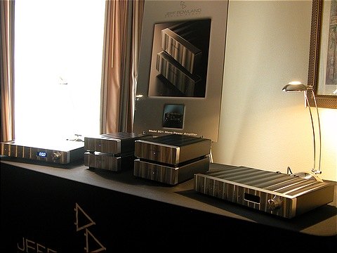

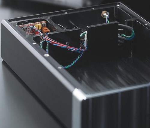

Jeff Rowland 201. Et kik i boksen.
 FYI, the technology used in the 201's is B&O's ICEpower - modules that JRDG buy-in from B&O. ICEpower is -
as far as I can understand - based on using the analog feed from inputs to modulate a digital "carrier". The modulated
digital carrier is then fed through a digital gain stage for amplification, then fed to a de-modulator which reconstructs the
amplified analog signal. This approach yields a very high efficiency (>80%) and makes for a very cool-running amplifier.
To give you an idea, each monoblock is about the size of a phone book, delivers 250w into 8 ohms / 500w into 4 ohms,
will cope with a current demand of up to 35 amps and the whole unit seldom gets more than 2-3 deg C above ambient
temperature!! (see image below)

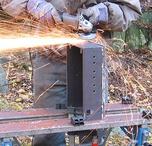

Dine nye ICEpower kabinetter laver du da selv, ude i haven. Se her hvordan:
