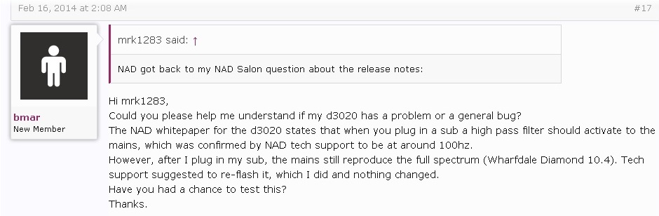

There’s also a subwoofer output, unusually, an eighth-inch minijack, which engages a 100-hertz low-pass filter when a plug is
inserted. There is no high-pass option for the speaker outputs, which utilize solid, five-way binding posts.

20347300">http://www.avforums.com/threads/picked-up-the-nad- d-3020-last-friday-ongoing-thoughts-pics-etc.1842074/#post-
20347300
Jeg har ikke nogen high pass filter som virker, med kabel i subwoofer output (ingen subwoofer tilsluttet i den anden ende), har
jeg lyde under 100hz

Der står "For those wanting to further increase bass output we include a subwoofer output that also engages a high pass filter for the D 3020 outputs" det tolker jeg som om at der er et filter, men det er også det eneste jeg har fundet, så det er måske en skrive fejl.
