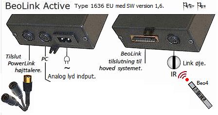

Her finder du oplysninger om BeoLink Active type nr. 1636.
http://www.bang-olufsen.com/beolink-active
BeoLink Active -  Opsætningsvejledning
http://www.bang-olufsen.com/UserFiles/File/ug/BeoLinkActive/ beolink-active_settingupguide_danish.pdf
User guides - BeoLink Active
http://www.bang-olufsen.com/UserFiles/File/ug/BeoLinkActive/ beolink-active_userguide_danish.pdf
BeoLink Active type nr. 1636. Pris 2.395 Kr.
