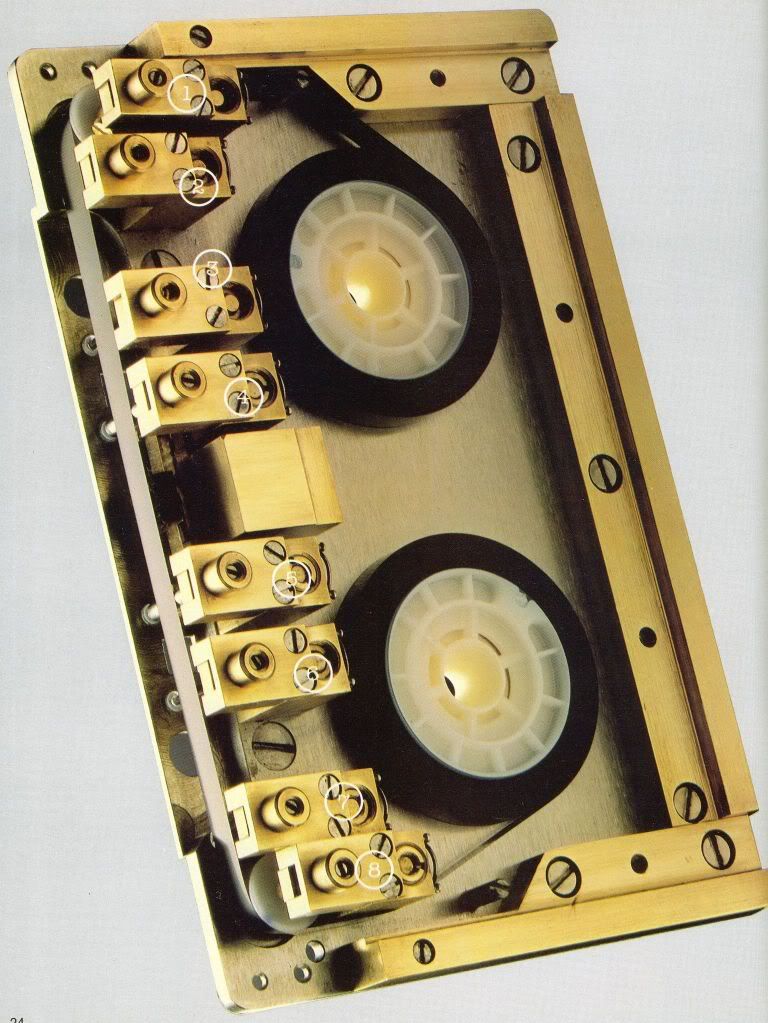

I et eller andet nummer for længe siden mener jeg magasinet High Fidelity viste et billede af den test jig BASF havde lavet i kobber eller messing, der kunne simuleret en casette
nogen der kan huske det, og eventuelt har et billede af tingesten
-Jan

Det er et nummer fra 80'erne i hvertfald og det var ikke som jeg husker det en test, men en metal udgave af deres kassette sådan at man kunne med små skrue justeringer efterprøve forskellige båndløb helt ned i microstørrelses finjustering. Så kunne man udfra det lave en prototype af et nyt bånd.

en bekendt i england havde BASF manualen ( http://www.ant-audio.co.uk/Tape_Recording/Library/Calibratio n_Mechanism_Manual.pdf ) det er beskrevet i - den ene jig så sådan her ud

Sendt: 02 Oktober 2012 kl. 08:47 | IP-adresse registreret
Der er kun 1 ting at sige : tusind tak :)
en bruger på Adio karma, der er tidligere BASF chef, har fortalt følgende, omkring dette virkeligt dyre test-sæt :
citat:
The picture posted by Jan_Stevns is of a Calibration Mechanism. There were two versions: the Mechanical Alignment version and the Azimuth alignment version. The former had "floating" roller guides to allow any misaligment of pinch roller/capstan to move the guides out of range and cause azimuth misalignment. The latter had tightly controlled rollers. If there were a difference between the two in terms of azimuth measurement, the ppinch roller or capstan had to be adjusted for best contact between the two until results with both mechanisms were exactly the same.
The "master" measurement tool was the Messe-cassette. I believe three were made at a cost of well over $100,000 each. Every possible contact point was adjustable in order to measure geometric differences and their effects. Once this cassette was aligned to perfection, it was used to calibrate the slant measurement tool. This tool had a pressure-sensitive pin that contacted all the internal parts to make sure that they were aligned exactly like the Messe-cassette when it was adjusted exactly right. All Calibration Mechanisms and alignment cassettes were measured against this tool, as were batch samples from our housing molds. If a Calibration Mechanism were dropped by a customer, we automatically replaced it with a new one once the older one was returned; and we remeasured the older one to see if it were still within specification. If not, it was scrapped and the internal parts recovered for reuse.
We sold Calibration Mechanisms to every music label and every major duplicator in North America at one point or another as well as to C-0 manufacturers. Columbia/CBS/Sony bought a slant test rig also, which ended up with Sony in Japan
