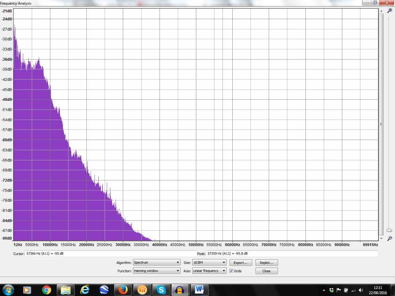

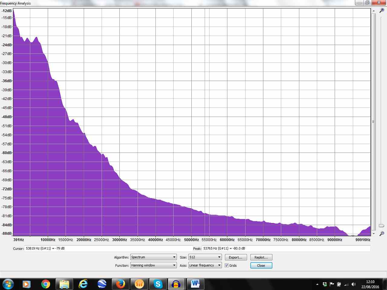

Hej,
Jeg har nogle lydfiler, optaget med udstyr med samplerate op til omkring 200 kHz, da jeg er interesseret i ultralyd over 20 kHz. Jeg vil gerne analysere disse lydfiler, og har brugt Audacity, og funktionen Plot Spectrum under Analyze menuen, i Audacity.
Her er mit spørgsmål, når jeg anvender skifter "Size" fra 512, til f.eks 16384, kan jeg se at opløsningen bliver bedre på plottet, men tilgængæld forsvinder de høje ferkvenser. Hvorfor har "size" indvirkning på det viste frekvens plot, og hvilke af de to plot repræsentere best frekvens indholdet i min optagelse?

Lage ovennævnte spørgsmål ud på "Audacity Forum", og fik følgende glimrende pædagogiske forklaring, måske det kan være hjælp for andre:
Try picturing it as physical "things" rather than "frequency components:
Imagine that you are collecting berries from a bush and you have several baskets to put the berries in. While you are picking the berries you sort them according to size, so, if you have 3 baskets, then you put the biggest berries in basket #1, the medium berries in basket #2 and the smallest berries in basket #3. When you have picked all of the berries from the bush you can count how many berries are in each basket.
Now imagine that rather than 3 baskets you have 6 baskets, and again you sort the berries according to size: biggest in basket #1, next biggest in basket #2 and so on up to the smallest berries in basket #6.
Assuming the same number of berries in both cases, it's obvious that when you have 6 baskets, there will be less berries per basket than when you have 3 baskets.
A similar thing is happening with FFT analysis - the more frequency "bins", the less will be in each bin.
