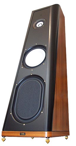

finn52
Bruger siden: 29 April 2004
Indlæg: 1380
Sendt: 21 November 2005 kl. 16:29 | IP-adresse registreret
I mine øjne, er det mest interessante idag, amerikanske Thiel. De bruger passiv bas i alle deres højttalere, og de bliver rost til skyerne i alle HiFi-tidsskrifter.
Der er desværre ingen danske forhandlere, men inden jul skal jeg til Tyskland, og håber at få "en lytter".

finn52
Indlæg: 1380
Sendt: 22 November 2005 kl. 09:33 | IP-adresse registreret
Fra Stereophiles konklusion, efter test af CS 2.4:
If I knew the way I would take you home
The Thiel CS2.4 is not a perfect loudspeaker—that's a critter I've never encountered at any price—but it's hard to fault within its price range. It's a whole lot of speaker for the money. It's built to a flawless standard. It's drop-dead gorgeous. It commits itself to music as an acolyte commits himself to a religion, which is to say without restraint. I'm tempted to similarly throw off restraint in singing its praises.
Thiel laver alle enheder selv, også de passive.
